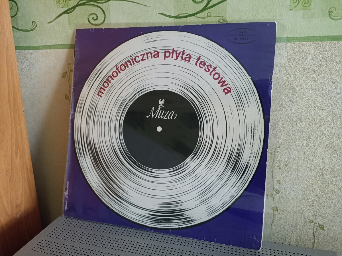

Re: Płyty testowe
#126
Post autor: kaf »
Zestaw 1: Revox B 150, Revox B 260, Revox B 226, Miida M 6000 P + AT 20 SLa, Pylon Opal 20
Zestaw 2: Siemens 777 Series, , Revox A77, Philips CD 303, Radmor LS 10
